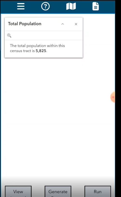

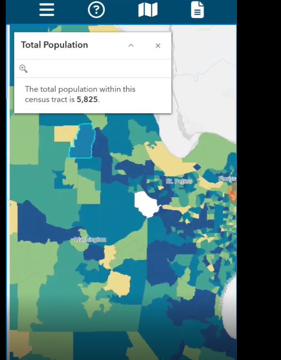

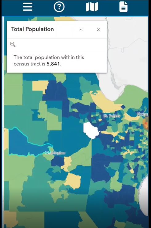

Hello everyone!
I'm encountering an unusual issue and haven't been able to find any information on it. We've developed a web service that functions well on desktops. However, on mobile devices, there's a brief white flash when clicking a feature, just before it highlights  the feature and updates the pop-up. I'm not sure what's causing this and would appreciate any insights on how to prevent it.Video Demonstration is attached below.
Thank You!
