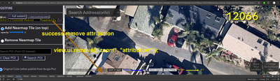

hoogw
SUCCESS, it works !!!! v4.31. 2025
view.ui.remove(["zoom", "attribution"]);
Screenshot 2025-02-08 at 5.43.39 AM.pngScreenshot 2025-02-08 at 5.43.39 AM.png
