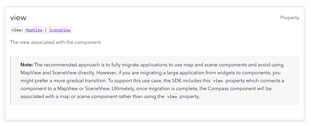

We are currently migrating our ArcGIS widgets to the new web components, but we have encountered some ambiguities in the documentation.
In our Angular application, we use a large number of widgets that are positioned outside the map component — for example, widgets that are (deeply) nested within navigational tabs.
Currently, we are assigning the view directly to the nested components following the documentation.
An example of this approach (compass positioned within a header) can be found here: https://codepen.io/insabelter/pen/RNRgBEy?editors=1111
At the same time, the documentation states that this approach should be avoided:
Docs: https://developers.arcgis.com/javascript/latest/references/map-components/arcgis-compass/#methods
What is your recommended approach for migrating such components that are not direct children of the map-component?

Hi, you can use the reference-element attribute to associate the component with your map. Just set the reference-element to the map's ID and that will connect them! Here's an updated version of your codepen: https://codepen.io/annefitz/pen/PwzjgLw?editors=1001

Insa_bel
Thank you for this solution!
I was skeptical about whether this would work with Angular components, since the id is set in a different component than the one containing the element where the reference-element is defined.
But it seems to work!
