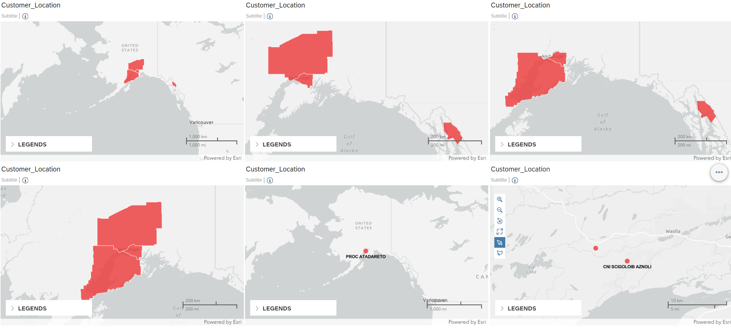

We were doing some profiling of our application as we moved from Esri 3.x to Esri 4.29. We basically had an application with 6 maps using just a GraphicsLayer on each map and drawing various polygons representing different regions.  We just load our application and render the 6 maps like this:

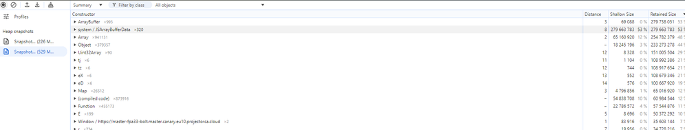

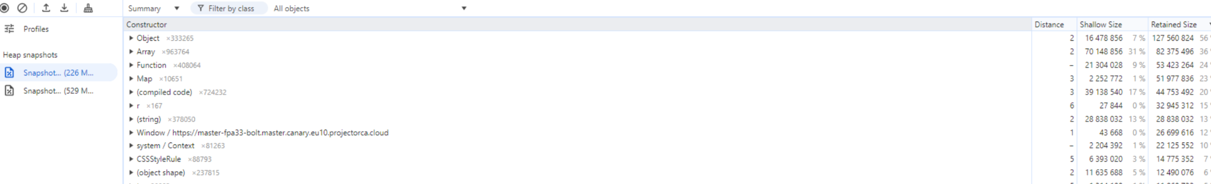

With Esri 3.x,  the heap snapshot is around ~ 220MB.

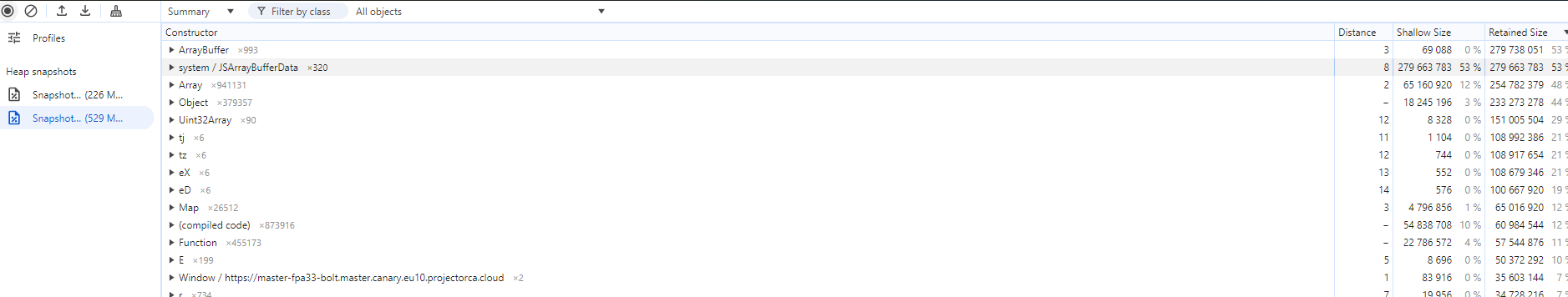

Loading the same application with Esri 4.29, the heap snapshot is more than double at a whopping 520MB+ !
Obviously the first biggest difference are all these ArrayBuffers and JSArrayBufferData objects - many of them seem related to the Esri 4 MapView and probably WebGL i presume but this incredible that the memory usage would double?

I've also been tracking memory in our application and see the huge JSArrayBufferData objects. These seem to be mostly owned by the MapView in something called mosaicData.
