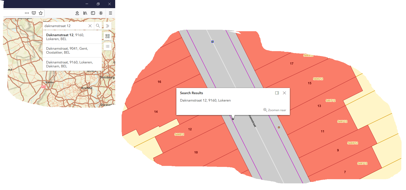

Hi Serge De Backer,
Hmmm, I don't get your example with the custom Locator running, not in IE, nor in FF or Chrome. I don't know how to find an address in Belgium with your application... And when I follow the link to the provider you are using (https://loc.api.geopunt.be/geolocation/location), my browser stops me from doing so because of possible security issues. It remains a challenge to get your custom Locator running.
So, why don't you just use Esri's World GeocodeServer? You mentioned the disadvantage of the address points falling outside the actual building footprints (see screen capture below). But there are also a lot of advantages, like easy and straightforward implementation and the provision of suggestions while typing your address (see also screen capture below).

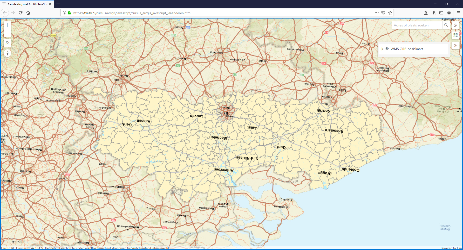

I quickly created a little example application for testing purposes: Aan de slag met ArcGIS JavaScript - Vlaanderen (please feel free to check and modify the source code).
I would be interested to see your final solution working.

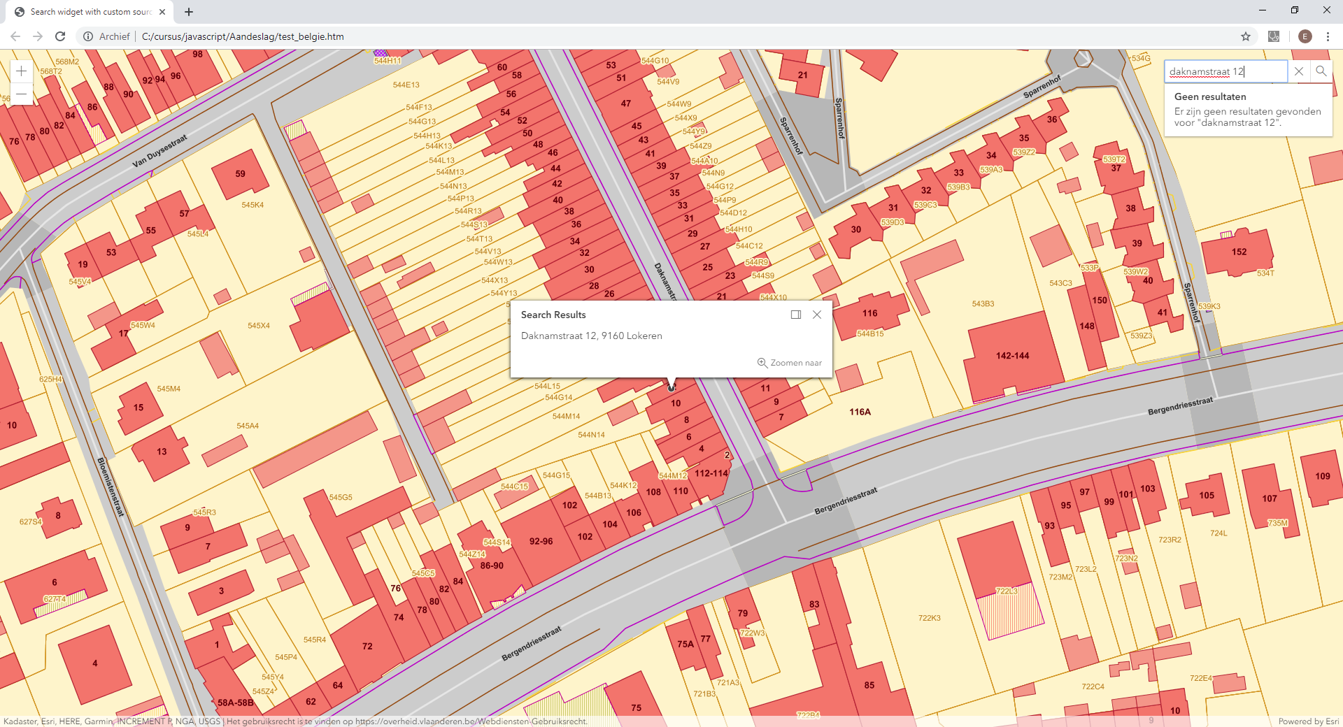

Cool! I did some testing and yes, it works now, even in Internet Explorer...!! So, I guess you should mark your own answer above as correct to close this call. (Yes, you solved your own issue so you should be allowed to mark your own answer as the correct one...)
A few test results:
  • The number of suggestions (just one) is quite limited. Could this be increased to 5 or 6?
  • After finding and showing the right address, the search box shows a message that it could not find any results (see screen capture below). Would it be possible to suppress this message?

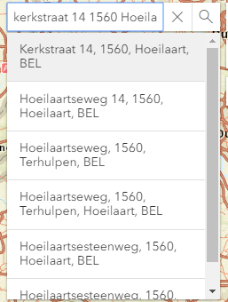

SergeDe_Backer
Hi Rene,
well I used the example from Egge-Jan and changed to locator to this
locator: new Locator({ url: "https://geocode.arcgis.com/arcgis/rest/services/World/GeocodeServer/?locationType=rooftop"}),
This works but when the result is clear it still gives me 6 suggestions even when the address is fully filled in
