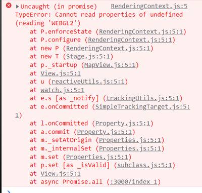

I am having the same issue.
Here are some things that I had tried and does not work:
1. Upgrade graphics driver to ensure usage of up to version OpenGL 2 to 3+
2. Under browser configuration example chrome://gpu, i enabled WebGL, and ANGLE to use OpenGL (i've tried all options as well)
3. Downgrade Chrome browser to older version
4. Tried using Chrome, Firefox, Opera different browsers all having same issue.
5. Upgrade to 4.26 and 4.27 shows slightly different error but all pointing to WebGL issue
6. Tried updated browserslist in package.json to use latest browser version, not IE v11 etc.
The following picture shows what I had encounter for Arcgis v4.27
I am suspecting this is an underlying issue with ArcGIS libraries (js-api), incompatible with the latest browsers and maybe GPU as well.
Hope you can find something out from it and let us know, because this issue can snowballed into something bigger if it does not get resolves before v4.28.
Thank you!

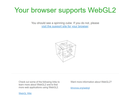

In this case we really would need to see a sample app to test this. From looking at the change notes however it could one of the Breaking changes at 4.26 where 3D Scenes now require a WebGL2-compatible device. Could you therefore test the following website to confirm this is not the case?
Many thanks,
David
JSFrost
My app does not have any 3D items neither using any 3D apis. I tested with the website you gave and yes my browser is webgl2 compatible.
