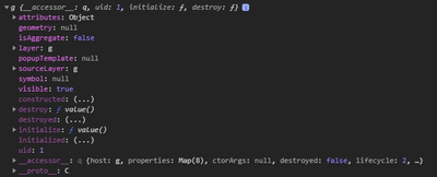

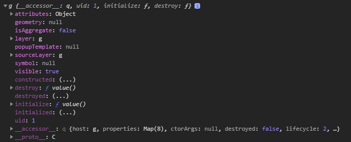

Hey, sorry for the late feedback, i was absent for a week.
I've tried your solution and it seems to works but not really, in fact, my feat[0}.geometry seems to be null...
That's weird.
