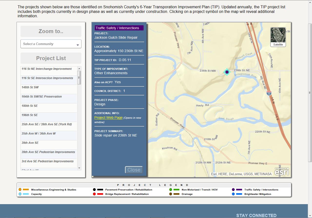

I'm currently developing a basic web map app for showing various projects. I'm using v3.10 of the API and started with the "Popup content in side panel" sample. Instead of a static side panel for a selected feature's information, I decided to use a jQuery slide panel that appears when the user clicks on a feature (see the screenshot). I have added a close button within my slide panel which will close the panel and fire map.graphics.clear() to remove the graphic of the currently selected item. This all works just fine.
What I want to do (can can't figure out the best way to do it) is close my side panel if the user clicks someplace on the map (but not on another feature). I tried to account for this using the following:
map.on("click", function() {
     if(map.graphics.graphics.length == 0) {
          //Close my side panel here
but the problem is that the click event fires before the selected graphic is removed and so map.graphics.graphics.length never equals zero. I've also thought about trying to tie into the map's graphicLayer and it's "graphics-clear" event but I can't seem to do it. The following returns null:
theGraphicsLayer = map.graphics;
So what am I missing? The app isn't public facing yet so I can't link to a live example.
Thanks!
Steve
Screenshot:

RobertScheitlin__GISP
MVP Emeritus
Steve,
  Here is a full working sample with sliding panel (no JQuery, just dojo).
<!DOCTYPE html>
<html>
<head>
  <meta http-equiv="Content-Type" content="text/html; charset=utf-8">
  <!--The viewport meta tag is used to improve the presentation and behavior of the samples
      on iOS devices-->
  <meta name="viewport" content="initial-scale=1, maximum-scale=1,user-scalable=no">
  <title>Sliding Info Panel</title>
  <link rel="stylesheet" href="https://community.esri.com//js.arcgis.com/3.10/js/dojo/dijit/themes/tundra/tundra.css">
  <link rel="stylesheet" href="http://js.arcgis.com/3.10/js/esri/css/esri.css">
  <link rel="stylesheet" type="text/css" href="http://fonts.googleapis.com/css?family=Open Sans">
  <style type="text/css">
    html,
    body {
      height: 100%;
      width: 100%;
      margin: 0;
      padding: 0;
      margin: 0;
      font-family: "Open Sans";
    #leftPane {
      width: 20%;
      margin: 10px;
      -webkit-box-shadow: 2px 2px 2px rgba(0, 0, 0, 0.6);
      -moz-box-shadow: 2px 2px 2px rgba(0, 0, 0, 0.6);
      background-color: white;
      border: solid 1px gray;
    #map {
      padding: 0;
      margin: 10px;
      overflow: hidden;
      position: relative;
    #header {
      text-align: center;
      height: 40px;
      margin: 10px;
      background-color: whitesmoke;
    #footer {
      border-radius: 8px;
      text-align: center;
      margin: 10px;
      height: 50px;
    #sliderDiv {
      top: 0;
      left: -420px;
      background-color: steelblue;
      position: absolute;
      z-index: 9999;
      -webkit-box-shadow: 5px 5px 5px rgba(0, 0, 0, 0.6);
      -moz-box-shadow: 5px 5px 5px rgba(0, 0, 0, 0.6);
      color: white;
      padding: 5px;
    #mainWindow {
      width: 100%;
      height: 100%;
  </style>
  <script src="http://js.arcgis.com/3.10/"></script>
  <script>
    var map;
    require([
        "esri/map", "esri/layers/FeatureLayer",
        "esri/tasks/query", "esri/geometry/Circle",
        "esri/graphic", "esri/InfoTemplate", "esri/symbols/SimpleMarkerSymbol",
        "esri/symbols/SimpleLineSymbol", "esri/symbols/SimpleFillSymbol", "esri/renderers/SimpleRenderer",
        "esri/config", "esri/Color", "dojo/dom", "dojo/_base/connect", "dojo/parser", "dijit/registry",
        'dojo/_base/html', "esri/domUtils", "dojo/fx", "dijit/layout/BorderContainer",
        "dijit/layout/ContentPane", "dojo/domReady!"
      ], function (
      Map, FeatureLayer,
      Query, Circle,
      Graphic, InfoTemplate, SimpleMarkerSymbol,
      SimpleLineSymbol, SimpleFillSymbol, SimpleRenderer,
      esriConfig, Color, dom, connect, parser, registry, html, domUtils, fx
      // use a proxy page if a URL generated by this page is greater than 2000 characters
      // this should not be needed as nearly all query & select functions are performed on the client
      //esriConfig.defaults.io.proxyUrl = "http://gislap183/Proxy/proxy.ashx";
      parser.parse();
      map = new Map("map", {
        basemap: "streets",
        center: [-95.249, 38.954],
        zoom: 14,
        slider: false
      map.infoWindow.set("popupWindow", false);
      //add the census block points in on demand mode. Note that an info template has been defined so when
      //selected features are clicked a popup window will appear displaying the content defined in the info template.
      var featureLayer = new FeatureLayer("http://sampleserver6.arcgisonline.com/arcgis/rest/services/Census/MapServer/0", {
        infoTemplate: new InfoTemplate("Block: ${BLOCK}", "${*}"),
        outFields: ["POP2000", "HOUSEHOLDS", "HSE_UNITS", "TRACT", "BLOCK"]
      function displayPopupContent(feature) {
        if (feature) {
          if (dojo.marginBox("sliderDiv").l < 0) {
            slideIt(420);
          var content = feature.getContent();
          dom.byId("sliderDiv").innerHTML = content;
      function slideIt(amt) {
        var slideArgs = {
          node: "sliderDiv",
          top: (dojo.marginBox("sliderDiv").t).toString(),
          left: (dojo.marginBox("sliderDiv").l + amt).toString(),
          unit: "px"
        var animation = fx.slideTo(slideArgs);
        animation.play();
      var symbol = new SimpleMarkerSymbol(
        SimpleMarkerSymbol.STYLE_CIRCLE,
        12,
        new SimpleLineSymbol(
          SimpleLineSymbol.STYLE_NULL,
          new Color([247, 34, 101, 0.9]),
        new Color([207, 34, 171, 0.5])
      featureLayer.setSelectionSymbol(symbol);
      map.addLayer(featureLayer);
      var popup = map.infoWindow;
      //when the selection is cleared remove the popup content from the side panel.
      connect.connect(popup, "onClearFeatures", function () {
        setTimeout(function () {
          var graphic = popup.getSelectedFeature();
          if (graphic) {
            displayPopupContent(popup.getSelectedFeature());
          } else {
            slideIt(-420);
            dom.byId("sliderDiv").innerHTML = "";
        }, 500);
  </script>
</head>
<body class="tundra">
  <div id="mainWindow" dojotype="dijit.layout.BorderContainer" design="headline" gutters="false">
    <div id="header" dojotype="dijit.layout.ContentPane" region="top">
      The project shown below are those identified
    </div>
    <div id="leftPane" dojotype="dijit.layout.ContentPane" region="left">
      This is left section stuff
    </div>
    <div id="map" dojotype="dijit.layout.ContentPane" region="center">
      <div id="sliderDiv" style="height: 98%; width: 400px;"></div>
    </div>
    <div id="footer" dojotype="dijit.layout.ContentPane" region="bottom">
      this is your legend
    </div>
  </div>
</body>
</html>
