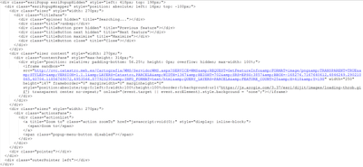

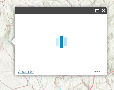

Every call to "ovc.catastro.meh.es" es been redirected though the proxy but then when the popup is triggered:

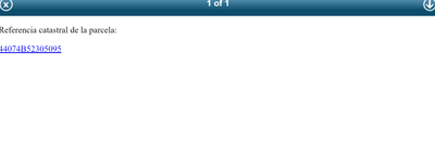

And if I edit the HTML directly it works:
Anyone know how to fix this? I'm not sure if this is an issue related to Web AppBuilder or to the ArcGIS API for JavaScript // cc: Jianxia Song, Lemao Wu, Robert Scheitlin, GISP, odoe

What I have realised that when I make my screen smaller It partially works and goes through the proxy:
but not when I am using whole screen and does not show the popup correctly:
I will be pleased if you can give me any clue about this. Thank you

I also think in the WMSLayer, the popup’s iframe URL is created by appending values to the layer’s featureInfoUrl property. So maybe you can also fix it by altering the property after the layer has loaded.
Cheers!
JunshanLiu
The httpProxy is used only if the request is sent by esri/request, but the URL in popup is not sent by esri request, so it does not go over the proxy.
So you'd better make your URL trusted by browser.
