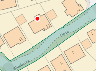

Hi
When zoomed in and the streets feature layer is available we are able to drop a graphic marker anywhere on the map.
I'd like to limit the graphic marker to be only able to drop it onto the feature (street) and not just anywhere on the map.
How can I do that?
This map will be used for reporting potholes on a street and the graphic will serve no other service other than visually showing (along with the popup that appears when you click on the feature) where someone has clicked to report the location of the pothole.
Thanks

Thank you. I've put the code in exactly as you have and sadly I'm still able to drop a marker anywhere on the map, it's not restricting it to the feature. I have a hit test on the streets feature layer (see example below) and I want to restrict the marker to only be dropped on this.
Your codepen is also still letting me drop a marker outside of this limitation.
I'm thinking, could I put the create graphic event inside the IF part of  hittest query? Therefore if the hittest is true allow the graphic to be created, else don't? I've tried to play around that but can't get it to work.
Thanks

Thank you for the update. I can confirm that is has now restricted the graphic to just on the feature layer. There is only one minor tweak that I need to make. On my original codepen (see link in topmost post) the graphic reset itself the next time you clicked on the map. I'd like it to still do this when clicking on the feature layer.
The code to restrict the graphic to only to the feature layer seems to have restricted it to one click only unless you reset it using the reset button I have. I've decided I no longer need the reset button (which I'll remove) and instead would just like the next click to reset and replace the graphic.
How do I please tweak your code to allow this? I'm then there.
Thank you for your valued assistance.
