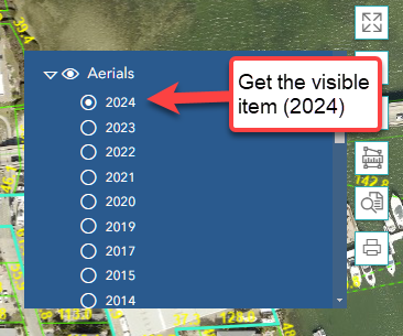

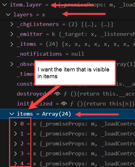

I have visibility watches on a layerList, but I cannot get the watches to hit on the items in the layerList when an item is selected. I want to get the visible item index when the item is chosen in item.layer.layers.items.
I can output the items in a forEach inside the listItemCreatedFunction, but I need to use a watch.

Hi @GregoryBologna ,
reactiveUtils when will only check for truthy values.  You would want to use a watch.   items isn't part of the public API.  You might run into issues.  This will also create a watch and a handle for each list item maybe unnecessarily?  Not sure on the use case here exactly.
What I would suggest is set up a single watch on map.allLayers something like this.  You could expand the filter logic to include only certain layers or layer types if necessary.

GregoryBologna
I didn't even think about using at allLayers. Thank you.
Here's how it turned out. Works just right.
