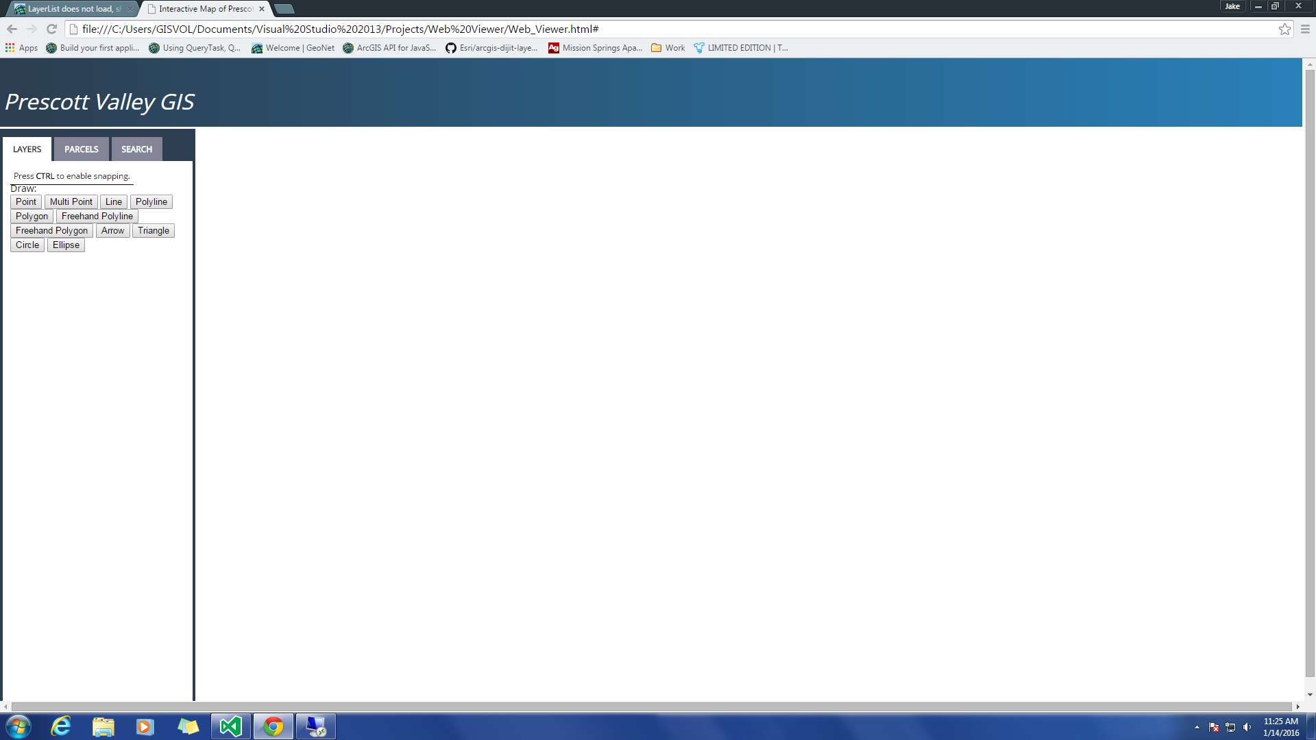

I tried the edits you gave me Robert and this is what happens whenever I use the "esri/dijit/LayerList", when it is supposed to look like this:
Also I checked the developer console and it gives me a 404 error in regards to the LayerList, so the problem is that LayerList is not connecting whatsoever to the web application I have running
