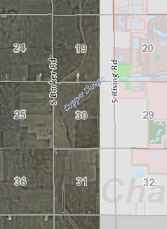

I am wondering if something changed on the layer swipe widget today?
Yesterday everything was working fine. But today I am experiencing the following issue.
When I initialize the map I call a function to create the layer swipe widget.
It loads and everything works fine.
But I have a check box to toggle the swipe tool and a drop down list to select the swipe layer.
When either of these are used I call the destroy() method on the widget and create a new widget using the exact same function that creates it in the map initialization.
When the startup() method is called this time the slider bar and slider handle is missing.
I thought it might have been something I changed that messed it up. But then I noticed the esri sample was experiencing the same issue.
http://esri.github.io/arcgis-dijit-layer-swipe-js/

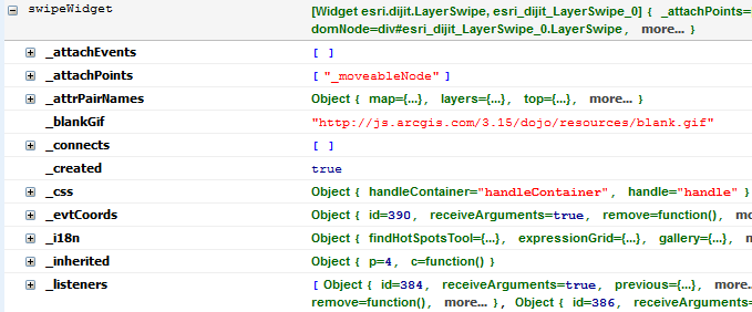

The weird thing is... The layer loads and is positioned correctly and I see the widget is created in Firebug.
The other weird thing is when I call destroy(), it removes my swipe div from the dom.
swipe widget is there on map load.
swipe widget (and hard coded div) are gone after destroy() / startup() sequence.
