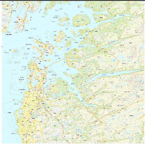

An example of a 50x50 cm map scaled down to fit 500px preview at the given map scale, using ArcGIS JS API
