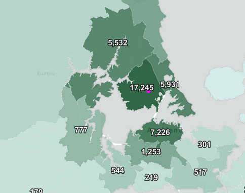

Map view of labels:

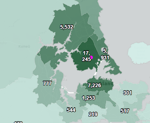

PDF showing wrapped labels:

The issue is probably caused by the comma and the space constraints, because the comma is a default stacking separator, and it looks like the wrapping only occurs where the space is tight. One workaround suggestion would be to set the deconflictionStrategy to none and see if that helps (or makes it look worse).

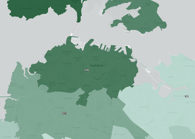

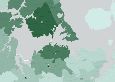

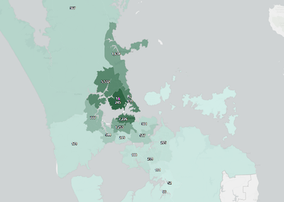

It is the comma in the label when it is printed (which is not the same as the map's labels). It doesn't seem to be because of the tight spaces. See the different scales and how the behave differently. There is also an example of the labels as a number. This is with deconflictionStrategy:"none",.
