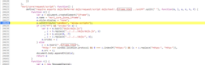

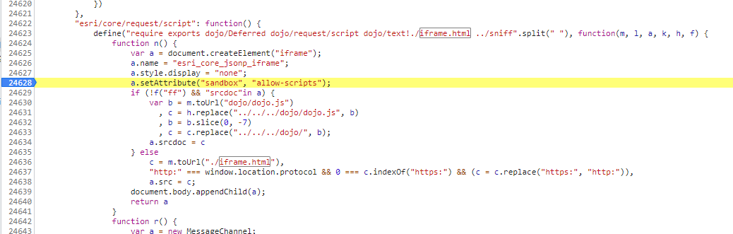

when i add a layer to map, i found the JSONP request lost its referer header,this may cause some problems.
the referer header is useful in our project.
and i have debugged  the  lastest version(3.31) like this:
so i have some test:

  var a = document.createElement("iframe");
  a.name = "esri_core_jsonp_iframe";
  a.style.display = "none";
  // referer has lost in request header if add this line
  a.setAttribute("sandbox", "allow-scripts");
  a.srcdoc = h
  document.body.appendChild(a);
  var a2 = document.createElement("iframe");
  a2.name = "esri_core_jsonp_iframe2";
  a2.style.display = "none";
  // i think this request header is nomal
  // a2.setAttribute("sandbox", "allow-scripts");
  a2.srcdoc = h
  document.body.appendChild(a2);
</script>
</html>
this function can run normal if don't add the "sandbox" attribute ,so why do you add the "sandbox" attribute? please let me kown,thank you!
