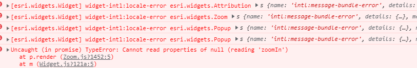

I am using the JavaScript API within a Vue CLI project. I get the following errors when the attribution, zoom, and pop up widgets load. These errors popup only when I use the the dev server that is provided with Vue CLI.
The above errors go away when the project is built and served on a web sever like IIS/Apache.
I understand this is a MIME type issue. What can I do to get these errors go away in my dev environment?

Are you trying to copy the assets locally? Can you provide a repo app, you might need to play with the config.assetsPath if you want the assets locally. Here is a demo app using vue3, the JSAPI and local assets.
https://github.com/odoe/vue-jsapi-calcite
I haven't run into MIME type issue with the cli server before, it's usually how the assets are being copied and referencing them correctly.

It ended up being an assetspath issue. I have fixed it. Thanks.
