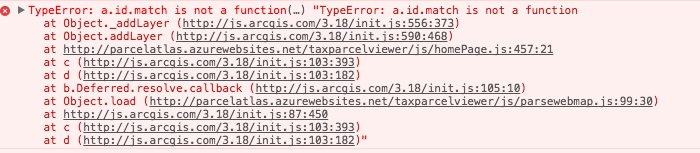

In all cases I get the following error: Type Error: a.id.match is not a function.

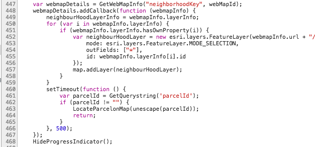

This is at map.addLayer on line 457, which runs without error under 3.11.

I tested it and I noticed that the issue is actually coming from the js/locator.js file in line 698, , acutally there is a code defect, since sometime map.getLayer(neighbourHoodLayerInfo.id) is undefined, and in  js api 3.11,it is not that sensitive, but in 3.18 it is more restrict on the code, so what you will need to do is just add another if statement outside of this if, so then it should look like this(I highlited the code that I added in line 697) :
line 696        for (var i in neighbourHoodLayerInfo) {
line 697                        if (neighbourHoodLayerInfo.hasOwnProperty(i)&&map.getLayer(neighbourHoodLayerInfo.id)) {
line 698                                  if (map.getLayer(neighbourHoodLayerInfo.id).maxScale <= ((mapScale) ? mapScale :
                                                  Number(dojo.byId("divShareContainer").getAttribute("mapScale"))) &&
                                                  map.getLayer(neighbourHoodLayerInfo.id).minScale >= ((mapScale) ? mapScale :
                                                   Number(dojo.byId("divShareContainer").getAttribute("mapScale")))) {
line 699                         PopulateNeighbourHoodInformation(neighbourHoodLayerInfo, mapPoint, null);
That fixed it!
