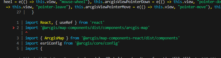

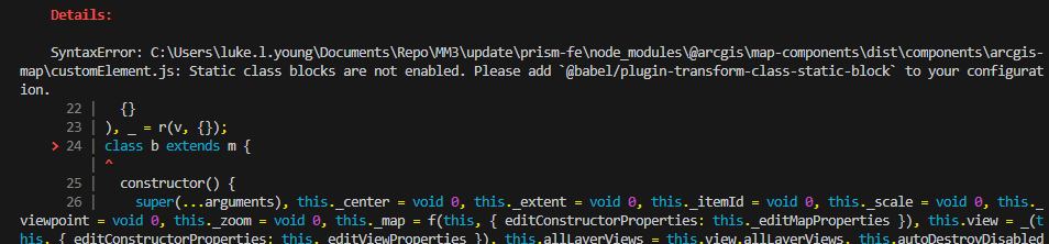

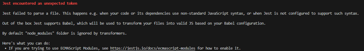

I have added @ArcGIS/maps-components-react 4.32.14 to our React 18.3.1 project. I am having issues running Jest tests on the new component.
Static class blocks are not enabled. Please add `@babel/plugin-transform-class-static-block` to your configuration
This error is saying that @babel/plugin-transform-class-static-block is not enabled. But that package is included in '@babel/preset-env' (babel-plugin-transform-class-static-block )
