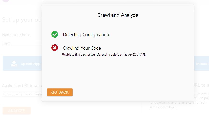

I am trying to use the JavaScript Web Optimizer, and i keep getting this error when i try to scan my website

TyroneBiggums
Deactivated User
Put line 16 above line 1, maybe? I think you'll need to reference the API, on line 16, before dojoConfig. I have the API referenced as my first script element, and I have a separate config.js script element near about the last script referenced.
Might not do anything for you, but worth a try?
