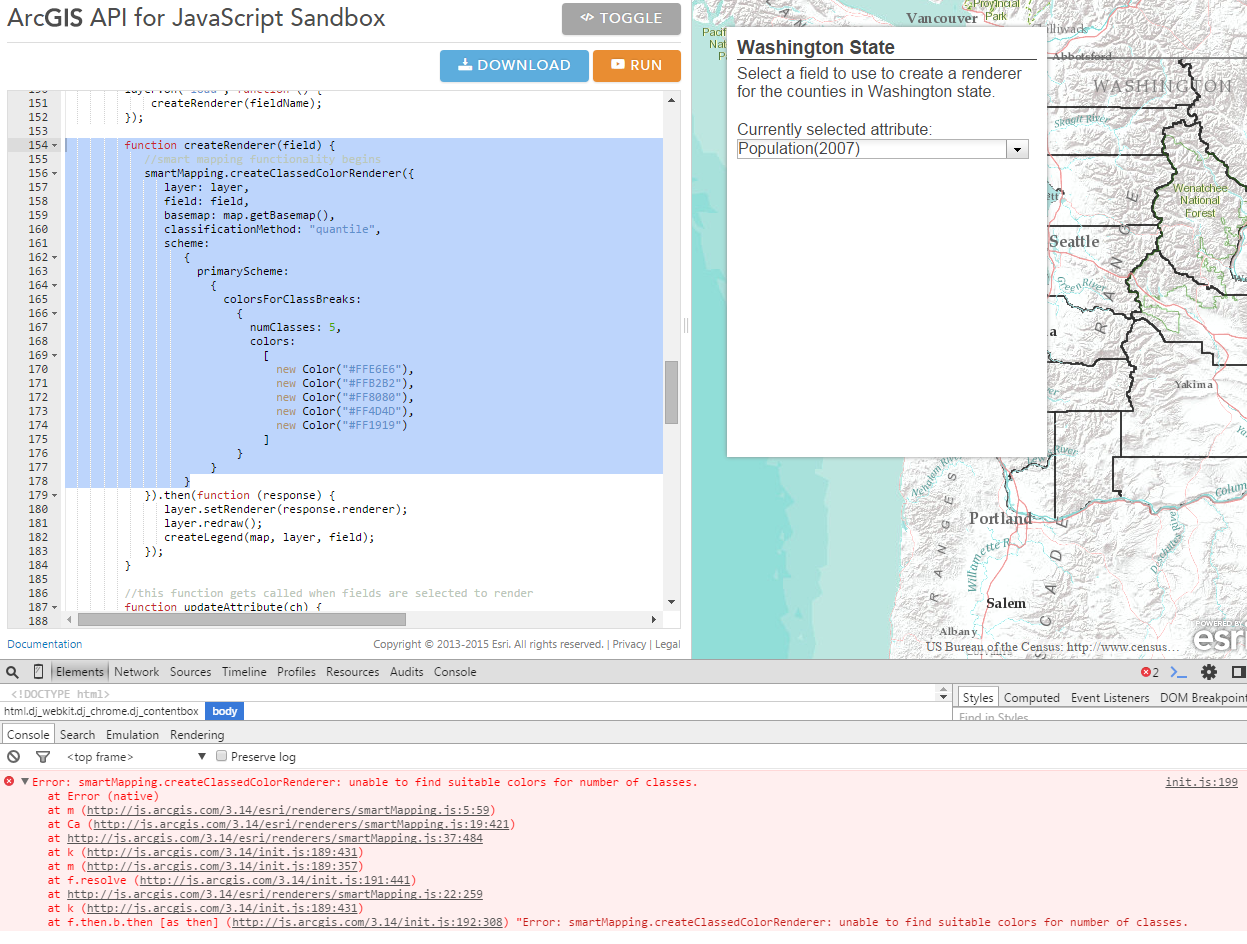

I quickly gave a stab at what I think it's expecting based on the documentation, but it's throwing an error - "Error: smartMapping.createClassedColorRenderer: unable to find suitable colors for number of classes."
ArcGIS API for JavaScript Sandbox
 function createRenderer(field) {
  //smart mapping functionality begins
  smartMapping.createClassedColorRenderer({
    layer: layer,
    field: field,
    basemap: map.getBasemap(),
    classificationMethod: "quantile",
    scheme:
  primaryScheme:
  colorsForClassBreaks:
  numClasses: 5,
  colors:
  new Color("#FFE6E6"),
  new Color("#FFB2B2"),
  new Color("#FF8080"),
  new Color("#FF4D4D"),
  new Color("#FF1919")
  }).then(function (response) {
    layer.setRenderer(response.renderer);
    layer.redraw();
    createLegend(map, layer, field);
