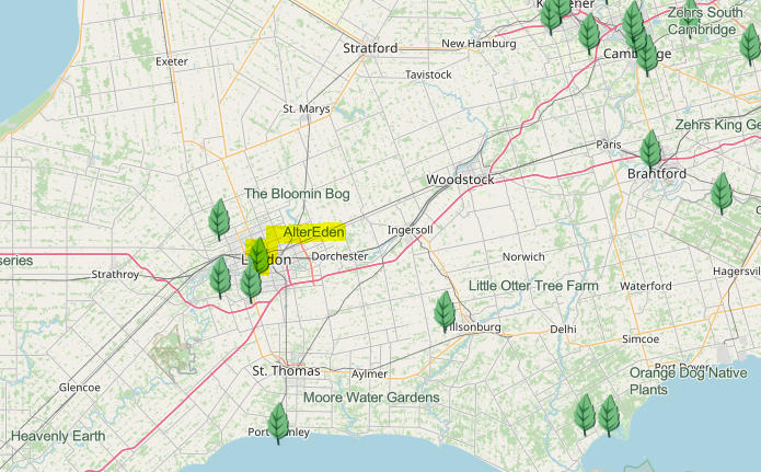

To illustrate the issue, here are a couple screenshots of what my map looks like when I don't try to incorporate syllabics into a label (just the pop-up). I've highlighted the feature that's relevant to my problem.
The labels look fine when I opt not to include syllabics:

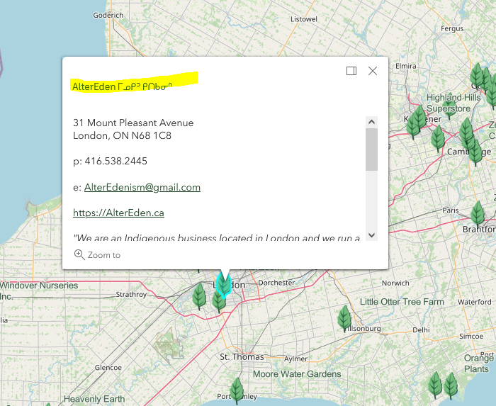

The pop up successfully displays syllabics:

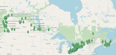

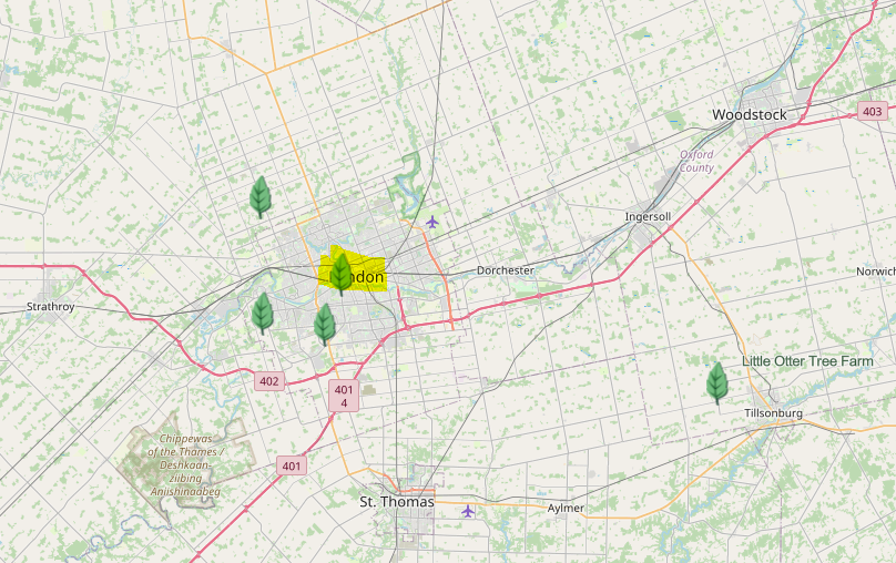

However, if I attempt to incorporate syllabics into the label (so it would read 'AlterEden ᒥᓄᑭᐣ ᑭᑎᑲᓂᐢ' on the map - just like the title of the pop-up), the entire label as well as those around it vanishes. (note: the text near the point in the screenshot below is from the basemap, not a label).

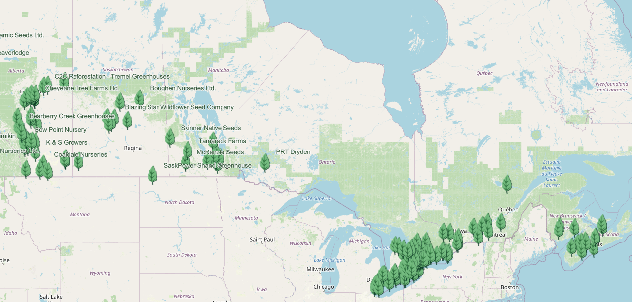

The effect is even more pronounced if I zoom out on my map (which encompasses all of Canada) - all of the eastern half of the country is now missing its labels, apparently because of that one feature label in Ontario containing syllabics.
