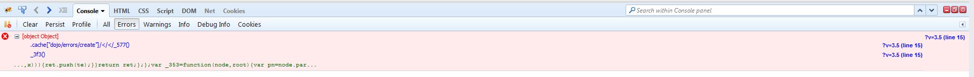

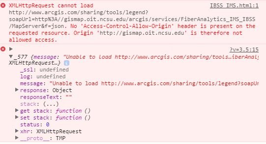

I am using this code: https://www.arcgis.com/home/item.html?id=9b6280a6bfb0430f8d1ebc969276b109 for a Table of Contents in my application. I'm using an older version of the API (3.5). I have been working on making my app work in Web App Builder so I haven't touched the code on the Javascript API version in a few months. I noticed yesterday the ToC wasn't loading properly. I turned on Firebug and got an error I can't really interpret. I also got some in Chrome as well. I've attached the images of the errors below. Anyone have any insight? I know it was working recently. Again, I haven't touched any of the code in months so something has happened I'm just not sure what. I was hoping that this application would be working for a presentation I have next week so any help to get this working again would be great.

Hey Jessica,
It might be helpful if we could see your code, it is tough to troubleshoot with only seeing the error message.

TyroneBiggums
Deactivated User
I saw something like this yesterday. That user does not have access to that ncsu service. Are you able to open that service on arcgis online outside of your application?

Hmm, well what probably happend (not that it's helpful) is that the javascript threw up at that header because of that error and wouldn't continue rendering that bit. Maybe?
Maybe, also, the security of that service has changed since you grabbed a screen capture for your presentation?
Why I brought up ArcOnline is to just add a layer with that service to see what happens. It could rule out it being an issue with the actual service is all I meant.
