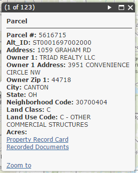

Hello All,
Does anyone have an example of how to call a function from inside a popup window?  I've been digging around the forums and haven't had much luck in finding a sample of what I am trying implement.  Right now, I have a Popup Template set up that shows basic attributes for the selected feature and also provides links to various resources regarding that selected feature.  See the image attached.
Below the Recorded Documents link, I'd like to add an "Open Old Tax Map Image" link that calls a function instead of opening a link.  I have tried a handful of things including using code from this sample ​but I can't get anything to do exactly what I have described.  Does anyone have an idea as to how I can accomplish this?
Any help is appreciated!
Thanks,
Ryan

RyanSellman
Deactivated User
Robert,
That's great!  I never thought of hiding the link in the templates it does not need to be in.  However, given the nature of the function I am calling, it would be ideal have the link below the two others already present (Property Record Card & Recorded Documents) and not in the actions list section next to "Zoom to".  Do you know of a way to get the link in the same area as the others?  If not, no biggie.  I can certainly make the sample you provided me with work.
Thank you again for all your help!
Ryan
RobertScheitlin__GISP
MVP Emeritus
Ryan,
   I currently have not tried to call a function from the popup content section, so I don't have a sample for that.
RyanSellman
Deactivated User
No worries at all!  I will make your sample work.  Thanks for answering my initial question.
Ryan
RyanSellman
Deactivated User
Hi Robert,
I know I marked this thread as answered, but I am still having some issues implementing the code you supplied.  Creating a link and calling a function when that link is clicked is no longer the issue.  Rather, my problem now occurs after the pop up is shown and set (after the map click event).  When I try to click the map again, with the popup window still open, I get a message in the console saying "Cannot read property '_layer' of undefined".  The same is happening with the sample you posted above.  Any ideas why this is happening?
Ryan
MVP Emeritus
Ryan,
   Sure just use this updated function:
      function checkLayer() {
        var feat = popup.getSelectedFeature();
        if(feat && feat._layer && feat._layer.name === "KS_FIELD_OUTLINES_SPRING2005_GEONAD27"){
          domStyle.set(query(".actionList > .action.mylink", window.map.infoWindow.domNode)[0], "display", "") ;
        }else{
          domStyle.set(query(".actionList > .action.mylink", window.map.infoWindow.domNode)[0], "display", "none");
RyanSellman
Deactivated User
That's it!  Thank you so much!  If you get a chance, could you describe what was happening?
Thank you again!
Ryan
