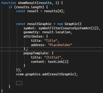

Here are some snippets of the relevant pieces of code:
this is within a large for loop, so all the links in this array is set to thisthis is within a large for loop, so all the links in this array is set to this

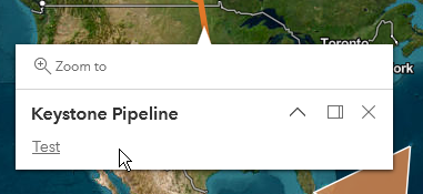

what the popup looks likewhat the popup looks like
what it looks like in consolewhat it looks like in console
