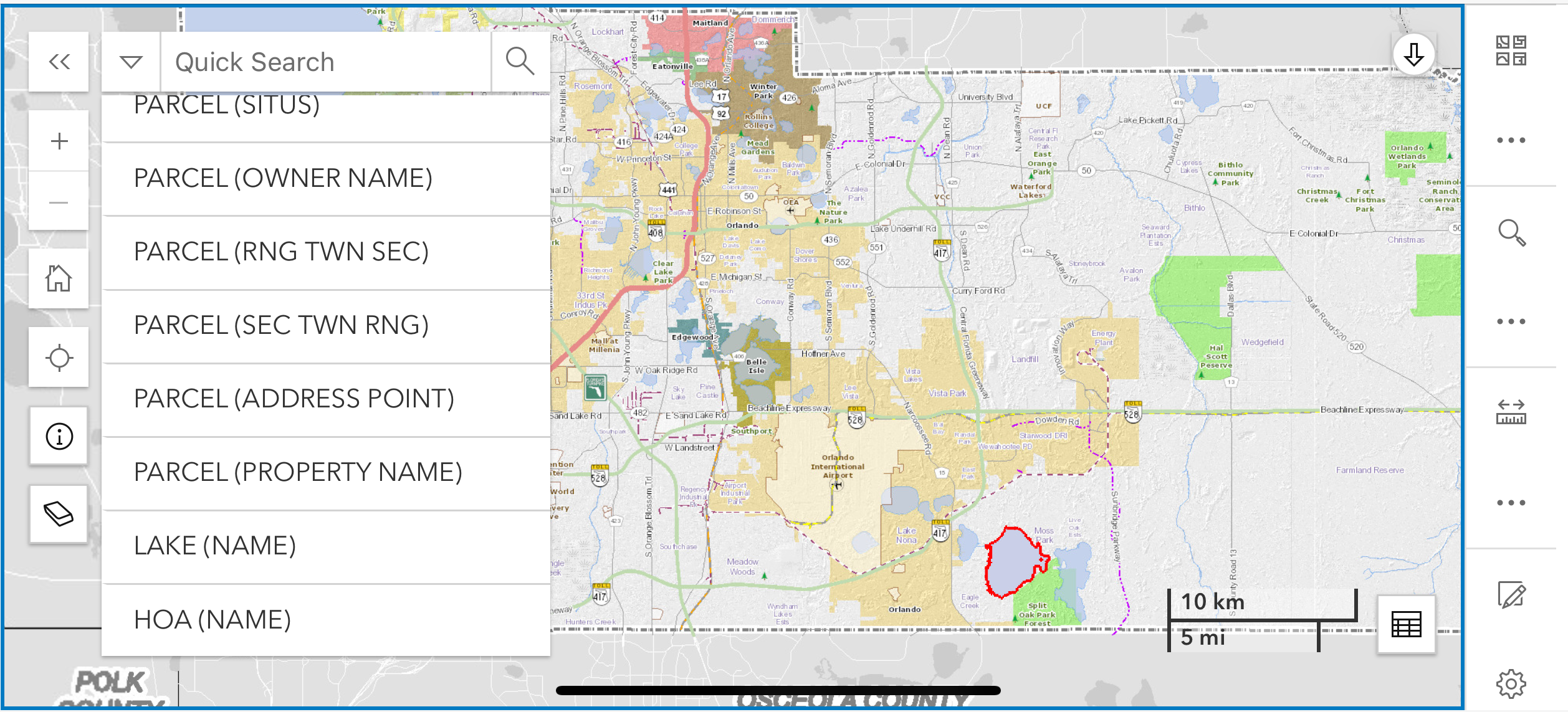

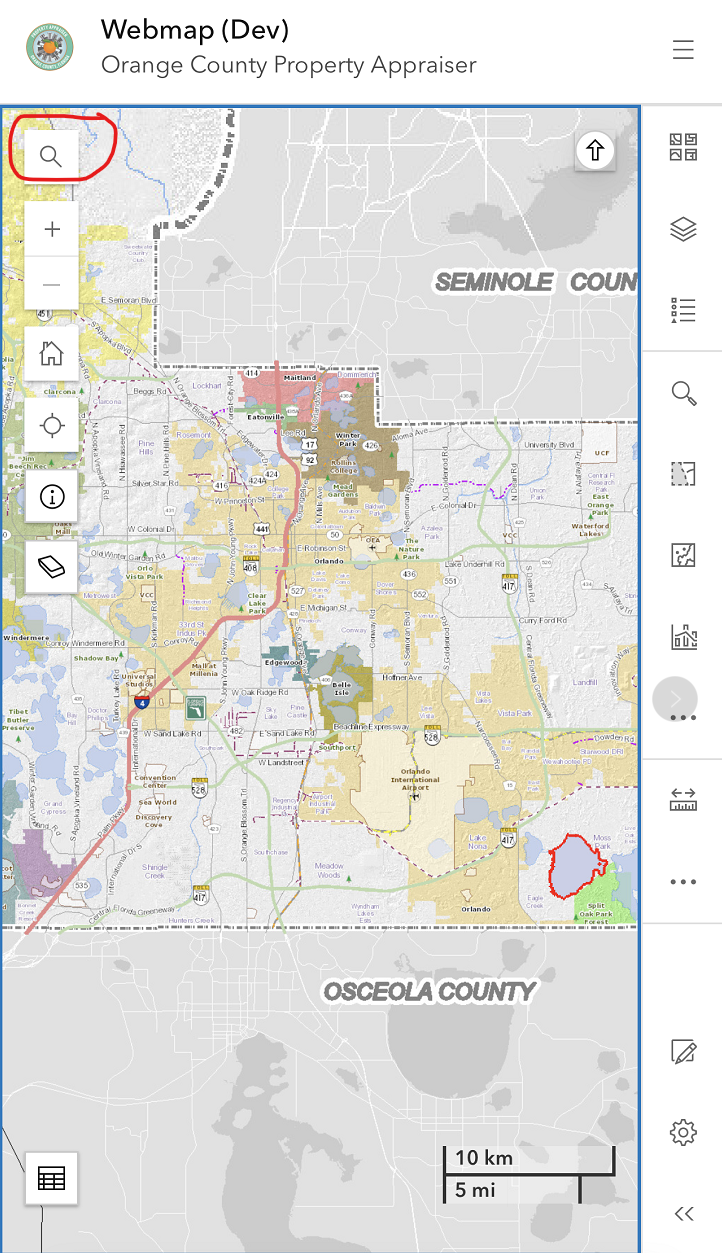

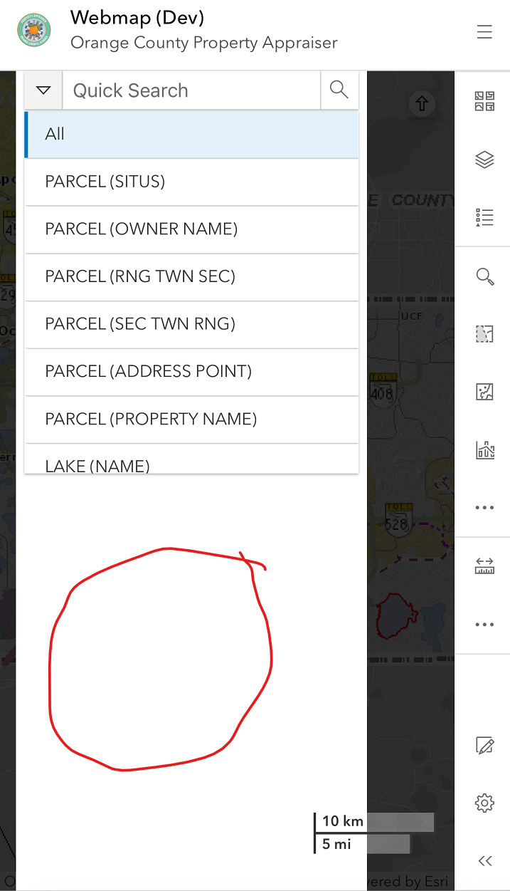

My web app used Search Widget with multiple sources. When opening it in mobile device (iPhone) with portrait orientation, I got issue below:
It's fine with landscape orientation.

By default, mode of Expand is auto, you can set to floating to prevent the drawer from showing on smaller screens.
https://developers.arcgis.com/javascript/latest/api-reference/esri-widgets-Expand.html#mode

ForrestLin
@ReneRubalcava
The issue is resolved by setting mode to floating.
Thanks.
