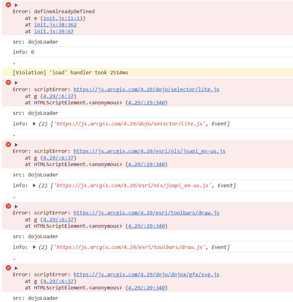

The situation we are in is we have an application in a browser window that downloads parts of the ESRI 4.29 JS arcgis API that we need  (using esri-loader).
Due to our requirements, our application in the same browser window would also need to be able to also load our maps with ESRI 3. However we do NOT need to support esri 3 AND esri 4 at the same time in the same window. We only need to use one or the other but not at the same time. We cannot open another browser window etc. - we'd be using the same existing one.

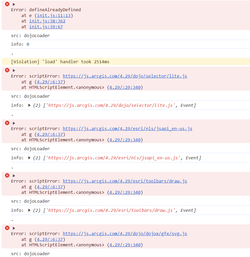

But what i'm seeing is when i try to load ESRI 3 (ie. https://js.arcgis.com/3.42/init.js), it blows up with errors like things already defined or i see in the network tab, it's trying to access esri 3 objects under the 4.29/ url so obviously there is state already initialized by 4.29 somewhere that is messing up loading of esri 3.x
My first hunch is there a way to unload or undefine eri 4  such that one can then load ESRI 3?  And vice versa?
Like are there objects in the global namespace that esri 3 or 4 initialized that i can null out, etc.  If it has to come to that, i'm willing to do it.  This is a scenario our application needs to be able to support.

Thanks. Yes in our case our users may not reload the page. That's the problem they can navigate through our system in such a way that they can load a document that uses esri 3 and then load another document that  we use esri 4.
i've been poking around the window namespace and see various things like $arcgis and dojoConfig defined. i am trying to blow those away to see what will happen.???
