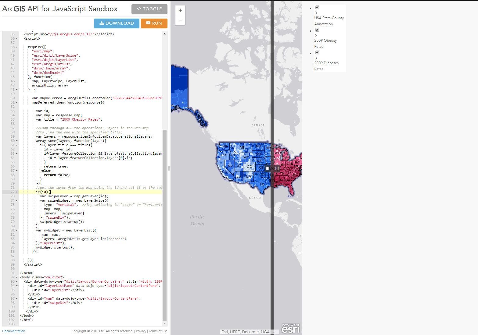

Is it possible to combine LayerList and LayerSwipe?
3021
08-05-2016 02:57 AM
JuliaRobertson2
Deactivated User
I've tried, but the LayerList is stuck above the map pane. I've tried changing the LayerList pane to "region: 'trailing' " and the map pane to "region: 'leading' ", but nothing changes. I've done it with and without a border container.

4 Replies
FC_Basson
MVP Alum
Remove the data-dojo-props attribute for both dividers and change you CSS:
#layerListPane{
   width:25%;
   float:right;
#map{
  width: 75%;
  float:left;
JuliaRobertson2
Deactivated User
Well that gets it in the proper place, but now it's taking up half the screen....
FC_Basson
MVP Alum
Here's the better solution:
