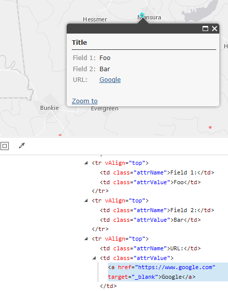

I have an application creating layers from an asynch JSON request - in the data pull, I have a field that contains a URL embedded within an anchor tag html element.
I am creating a featureLayer object from a featureCollection, which contains a layerDefinition where the URL field is defined. Everything works well - the layer loads with the proper symbology and all of my fields exist within the layer object; however, when the InfoWindow opens, the link automatically assigns "_blank" as the target:
Even If I explicitly set the target in the html element, e.g.:
<a href="http://www.google.com" target="_parent">Google</a>
We still end-up with "_blank" as the target.
I tried using a javascript function, e.g. href=javascript:window.open('www.google.com', '_parent');
But, the target is prepended. Is there something within the InfoWindow class that automagically adds the target attribute? Nothing jumped out while I perused the API class page:

                                "<b>2007 density: </b>${POP07_SQMI:compare}<br/><br/>" +
                                "<b>2000: </b>${POP2000:NumberFormat}<br/>" +
                                "<b>2000 density: </b>${POP00_SQMI:NumberFormat}<br/>" +
                                "<a target='_self' href=http://en.wikipedia.org/wiki/Olea_europaea>Wikipedia Entry</a>";
            else if (t2Checked) {
              templateContent = "<b>2007: </b>${POP2007}<br/>" +
                                "<b>2007 density: </b>${POP07_SQMI}<br/><br/>" +
                                "<b>2000 density: </b>${POP00_SQMI:NumberFormat}<br/><br/>" +
                                "Diff: ${DIFF:compare2}<br/>" +
            counties.infoTemplate.setContent(templateContent);

ChrisSmith7
Honored Contributor
Thanks - I had a feeling we'd probably have to go this route. I'll give it a go...
ChrisSmith7
Honored Contributor
This worked well...
