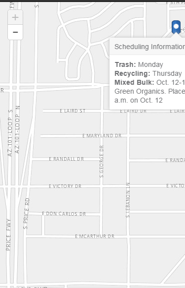

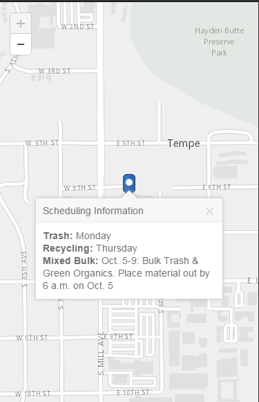

Our app returns a graphic point based on an address search. And we've encountered inconsistent behavior when it comes to the map centering on results.
Some addresses will return the graphic pt placed in the center of the map as intended:
While other addresses will return the graphic pt in the top left or right of the resulting extent:
And other address searches will center the map on an area where the graphic point isn't showing at all (though it's still returned to the map as evidenced by the user zooming out or panning).
