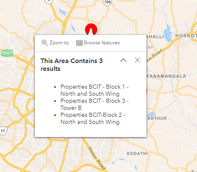

Hello,
Th inbuilt actions supported for the popup/popupTemplate are inconsistent, I keep seeing new action items on the popup each time. Even in the examples provided on the arcgis API documentation i see new popup actions most of the time. We use the same in our project too and see new options coming up sometimes even without updating the arcgis library versions. Any reason why this happens?
I see an option to remove the actions using view.popup.viewModel.includeDefaultActions = false;

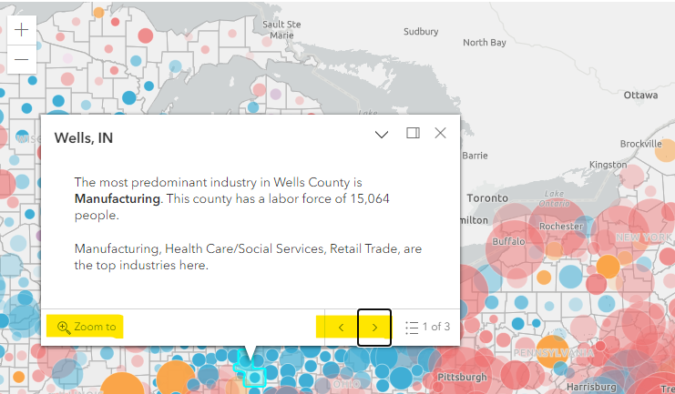

But is there a way to keep the actions consistent and have only zoom to and cluster features "1 of X" action for a popup template on a GeoJSONLayer as marked in the below screenshot.
Please kindly suggest on this at the earliest.

By default, the only action added to a popup in the JS SDK is the "Zoom to" action button (noted here). The feature pagination (arrows and feature menu button) shows up if you select an area in the map that has overlapping features. If feature reduction is enabled on the layer and it has a popup template, the "Browse features" action will appear as well.
Could you provide an example application where you see other actions appearing in the popup by default?

I am using a GeoJSON layer for the purpose of clustering and my pop up with this piece of code is as below:
As in the screenshot I see the Browse features coming up newly.
When i use this line all the actions Zoom to and Browse Features is removed.
So now my questions are:
1.) Is there a way to have only Zoom to option and not Broswe features?
2.) In place of Browse Features is there a option to show the feature pagination (arrows with feature number) just like this:
3.Also is there a way to find which pins belong to which cluster on the map.
I tried query methods on the GeoJSON Layer but it just returns the data based on the query where clause for that pin and doesnt tell to which cluster ID it belongs to. But I need to know which pins belong to which cluster to open a individual popup of only that property.
