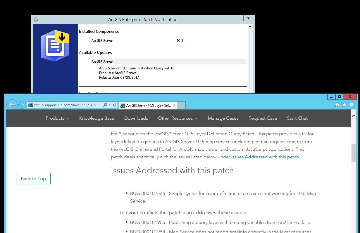

DonKang
I just posted my finding about ArcGIS Server patch and didn't see your posting.
I am wondering if ArcGIS Server patch will fix our issue without having to use 3.20.
I have 3.15 version configured locally, if ArcGIS Server patch is fix for something else, I will need to download 3.20 and configure.
I've tested little bit, so far I am able make things to work and I am using 3.15.
So the new ArcGIS Server patch seemed to fix the issue without having to use 3.20. (Not 100% confident yet)
Don
DonKang
Looks like a patch to fix our issue has been released just few days ago.
http://support.esri.com/download/7489

To the point of the patch - it's much easier to just update arcgis server than to update our web apps. So we will be trying this patch asap.

I had it fixed in our 10.5.0 install by applying the patch.  I've since updated to 10.5.1 hoping for a more stable release and this issue is happening again.
