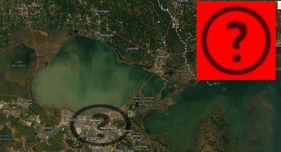

UndralBatsukh
Hi there,
I tested the MediaLayer with a 8 bit png with a transparent background and was not able to reproduce the issue you described. Here is the image I used: https://i.stack.imgur.com/RPEQQ.png
The one with red background is added as img on a div with a red background. The one on the map is added to the MediaLayer. The transparency is working expected.
If you see issue can you please provide a reproducible case?
Thanks
Lzy
I'm sorry. I think I didn't express myself clearly. 32-bit PNG images are opaque .The 8-bit PNG image is normal
UndralBatsukh
Hi there,
Ah should have realized that. I am able to reproduce the issue. We are tracking this issue and will update you as soon as it is fixed. Thanks for bringing this issue to our attention.
-Undral
