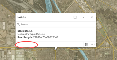

Identify with multiple results poped up. How to catch the click event of navigating on "previous" or "next" ?
236
a week ago
baohuachu7
Want to when navigating  on the popup results to create highlight and zoom to the selected results.  The layer is MapImageLayer , so some customization should be done on identify. But not get any idea to catch the click event on "previous" and "next" button.
