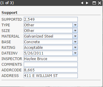

We have sign supports and street sign layers. Sometimes the layers will be stacked and the elements will be too. What do I need to do to navigate through the layers and the elements of the layer that are located at the exact same location?
Here is what I have to evaluate an individual element from the street supports layer:
 var supportId, type, address;
        app.supportLayer.on("click", function (evt) {
            supportId = evt.graphic.attributes.SUPPORTID;
            type = evt.graphic.attributes.TYPE;
            address = evt.graphic.attributes.ADDRESS;
            app.attributesModal.modal("show");
            document.getElementById("address").value = address;
            console.log(supportId);
            console.log(type);
            console.log(address);

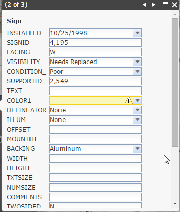

Here is an editor widget that does the same thing. I had to make a larger form for mobile devices:
