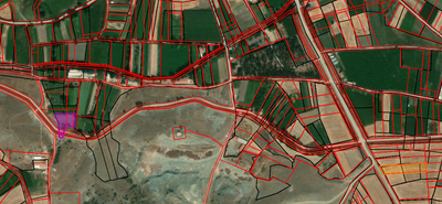

appeared on screen did not remove black graphics
I didn't get results.
It did not remove the black graphics appearing on the screen.
I cannot add or remove graphics with the checkbox

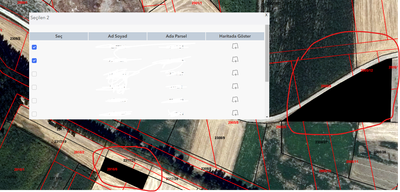

emreaktas1
hi @mleahy_cl
https://developers.arcgis.com/javascript/latest/sample-code/sandbox/?sample=widgets-featuretable-pop...
What I actually want to do is to show the data selected with selecet on the map, as in the example here.
By adding graphics this makes my application difficult to run.
How can I show the selected layer on the map in a simpler way?
mleahy_cl
Ok, it sounds to me like what you want is to highlight features.  You can highlight features on a LayerView (see the map view's `whenLayerView()` method) with a list of one or more object IDs.  That returns a handle object for that specific highlight.  When you want to remove that highlight, you use its `remove()` method.
Here's a sample: https://developers.arcgis.com/javascript/latest/sample-code/highlight-point-features/
The highlight method specifically (on the FeatureLayerView class): https://developers.arcgis.com/javascript/latest/api-reference/esri-views-layers-FeatureLayerView.htm...

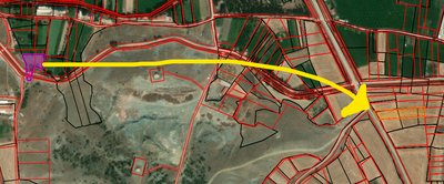

What is the method to add a line between 2 selected data as in the screenshot.
I want to add a line to the selected data as in the screenshot
mleahy_cl
That's a somewhat different question.  I think you'd be looking at creating your own geometry (e.g., a line from the centre of the highlighted item to some related location?), and either add a graphic using that geometry to the map's graphics layer, or to a client-side feature layer.  You could get the arrow effect with a CIM symbol
emreaktas1
hi @mleahy_cl
How can I make a line (eg Cım Symbol) from the center of the highlighted element to the center of the other highlighted element?
Is there any sample code on the subject?
mleahy_cl
I don't know of any examples offhand.  You can query the geometry for the features you're working with, and use those to derive start and end points (e.g., you can get a centroid from polygons).  Use those two points to construct a polyline geometry, then use that geometry to create your graphic to display on the map.
