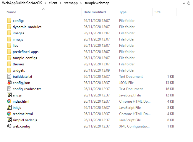

I have donwload my WebAppBuilder Web Map in a folder called 'samplewebmap'.  This webmap is very simple: only contains a sample set of points from a filegdb published from ArcGIS PRO in Portal, and some widgets that I have to customize.

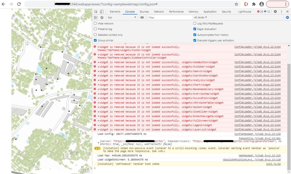

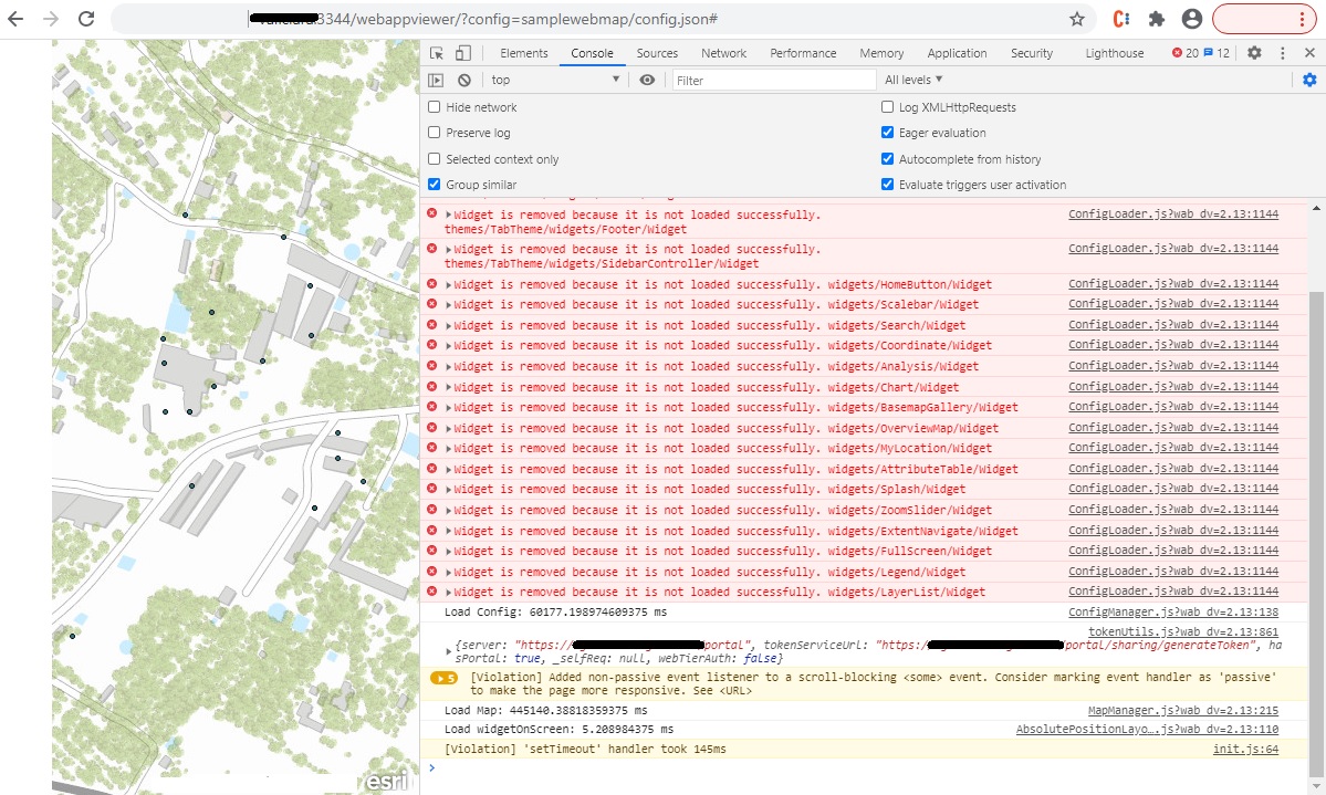

And I have called this URL,  https://localhost:3344/webappviewer/?config=samplewebmap/config.json# but the webmap doesn't open. After a while I have to enter Portal credentials but none of the widgets appears in the Webmap that only shows the basemap and sample data.

In case it helps someone, I have solved my own question saving downloaded ZiP file from Portal in \WebAppBuilderForArcGIS\server\apps  folder. I was wrong trying to save the ZIP file in WAB client folder as I have done before with custom widgets or ad-hoc web sites that I have developed.
