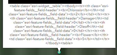

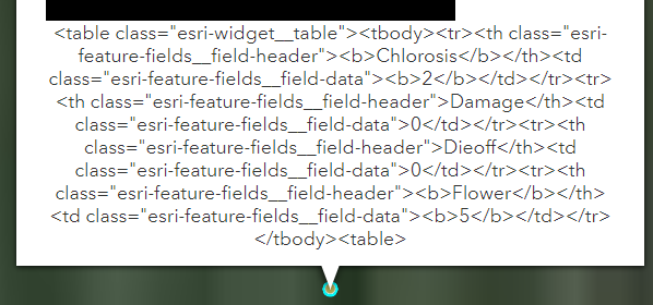

I have a React Functional Component. I would like to use this to show in PopUp in JS API 4.X ReactJS based application. I am using React V 17.0. The content from functional component is shown as html string but it is not rendered as html content.
My code snippet:
let customContent = new CustomContent({ outFields: ["*"],creator: () => {

Thank you very much for your help. Thank you for the blog and details. I tried to implement this. However, its re loading the whole page when ever I try to open the mapview's popup and not loading any popup. I am still trying to fix it.
