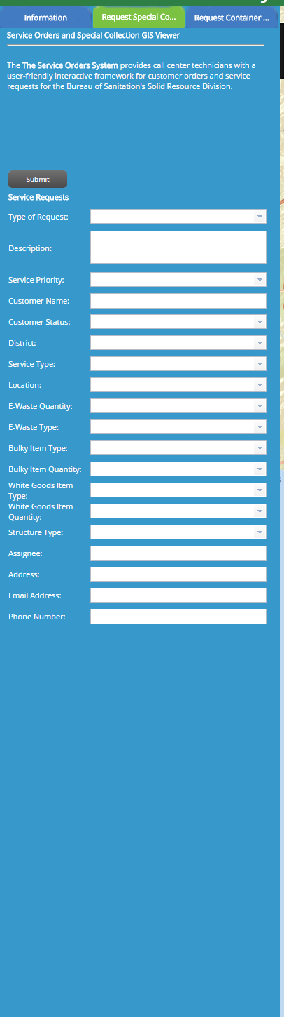

GeoffreyWest
Hi Riyas,
Please see Public Information Center
I have an application using this template and I have added a number of other requests fields such as quantity.  See my screen shot.  I would like the quantity field to be a value domain.
