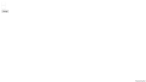

UndralBatsukh
Hi there,
You can loop through the graphics and update its attribute as shown below. No need to get _items, graphics is a collection.
graphicsLayer.graphics.forEach((graphic) =>{
  graphic.attributes.Owner = "Here here";
This codepen shows the concept - https://codepen.io/U_B_U/pen/aberQpp?editors=100
Sparkles
Hi @UndralBatsukh , thanks for the help! When trying to update visible to false, it works in the code snippet you provided ,but not in my React component. Do you think React could be interfering with this? as the component reloads and it seems the value is coming back from the default arcgis value "true" at that time. It seems that changing an attribute manually in the JS code just changes the value locally but doesn't actually persist the change to the arcgis data. Do you know if there's a built in method to use that would persist the change?
Thanks!
