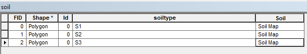

i am encountering problem with query i have to select three shapfile under one name as one unique value. it worked in arcmap but it does not work with arcgis javascrip api. my query is
esriRequest({
              url: "http://localhost:6080/arcgis/rest/services/........./query?where=Name ='" + id.toString() + "'&outFields=Soil&returnGeometry=false&orderByFields=Soil&returnDistinctValues= true&f=json",
              content: {
                f: 'json'
              handleAs: 'json',
              callbackParamName: 'callback',
              timeout: 15000
            }).then(lang.hitch(this, function(response) {
              var store2 = new Memory({
                data: []
              });but in coding when i have applied query it populate combobox like this in below image could anyone tell me what i am doing wrong?

FaryalSafdar
{"displayFieldName":"Id","fieldAliases":{"Soil":"Soil"},"fields":[{"name":"Soil","type":"esriFieldTypeString","alias":"Soil","length":50}],"features":[]}
it returns this.

FaryalSafdar
it returns this when i put query in the query form of layer
"displayFieldName": "Id",
"fieldAliases": {
"Soil": "Soil"
"fields": [
"name": "Soil",
"type": "esriFieldTypeString",
"alias": "Soil
"length": 50
"features": [
"attributes": {
"Soil": "Soil Map"
"attributes": {
"Soil": "Soil Map"
"attributes": {
"Soil": "Soil Map"
