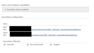

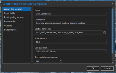

Please let me know if I am doing something wrong... here ar ethe properties of the composite locator for reference:
Here are the capabilities of the service:
