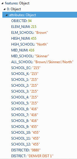

1) Do I use the SCHOOL_6 value in the outfields query parameter and pull that value, which yields this result:
additionally - how do I pull that value 416 if there is only ever 1 feature returned, but the field name could always change based on the drop-down?
or ...
2) Pull all the fields from the query layer, and select the attribute from the field that matches the value of the drop-down (ie. SCHOOL_6), and sift through the results that way. Here's what the results look like from pulling all the fields:

you can retrieve values from a known field a couple different ways...
attributes.FIELDNAME
attributes["FIELDNAME"]
the second syntax would be better for you if you want to substitute a variable.
MatthewBaker2
Deactivated User
JGravois-esristaff‌ perfecto! That works great and will let me do exactly what I need - substitute the variable from the drop-down to the result specific to the corresponding field... great stuff!!! Many thanks to both of you! cc jskinner-esristaff
