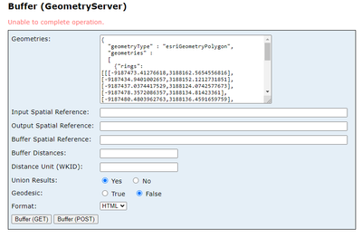

Given the geometry query below, how would I enter the parts into the ArcGIS Utilities Geometry (GeometryServer) query shown in screenshot?
ArcGIS GeometryServer queryArcGIS GeometryServer query
This is my json query
{"geometry":{"spatialReference":{"latestWkid":3857,"wkid":102100},"rings":[[[-9187473.41276618,3188162.5654556816],[-9187434.9401002657,3188152.1212731851],[-9187437.0374417529,3188124.0742577673],[-9187478.3572086357,3188134.81423361],[-9187480.4803962763,3188136.4591659759],[-9187482.82138976,3188137.7757820026],[-9187485.32981364,3188138.7357496503],[-9187486.1791619044,3188139.3302621851],[-9187486.9202693515,3188140.0552431336],[-9187487.5333208945,3188140.8913085815],[-9187488.0019252859,3188141.8161045313],[-9187488.31355339,3188142.8049045876],[-9187488.4598731585,3188143.8312710673],[-9187488.4369724244,3188144.867761869],[-9187488.6253482066,3188149.8298659292],[-9187488.28674475,3188154.78398642],[-9187487.4249764085,3188159.674315393],[-9187486.0497509651,3188164.4457635083],[-9187484.1765602734,3188169.0445806137],[-9187473.41276618,3188162.5654556816]]]},"outFields":["OBJECTID","PARID","PAR_MAIL_LABEL1","PAR_MAIL_LABEL2","PAR_MAIL_LABEL3","PAR_MAIL_LABEL4","PAR_MAIL_LABEL5","PAR_MAIL_LABEL6"],"outSR":{"latestWkid":3857,"wkid":102100},"returnGeometry":true,"spatialRel":"esriSpatialRelIntersects"}

Gregory,
  Here is what you put in the Geometries box:
  "geometryType" : "esriGeometryPolygon",
  "geometries" :
    {"rings":[[[-9187473.41276618,3188162.5654556816],[-9187434.9401002657,3188152.1212731851],[-9187437.0374417529,3188124.0742577673],[-9187478.3572086357,3188134.81423361],[-9187480.4803962763,3188136.4591659759],[-9187482.82138976,3188137.7757820026],[-9187485.32981364,3188138.7357496503],[-9187486.1791619044,3188139.3302621851],[-9187486.9202693515,3188140.0552431336],[-9187487.5333208945,3188140.8913085815],[-9187488.0019252859,3188141.8161045313],[-9187488.31355339,3188142.8049045876],[-9187488.4598731585,3188143.8312710673],[-9187488.4369724244,3188144.867761869],[-9187488.6253482066,3188149.8298659292],[-9187488.28674475,3188154.78398642],[-9187487.4249764085,3188159.674315393],[-9187486.0497509651,3188164.4457635083],[-9187484.1765602734,3188169.0445806137],[-9187473.41276618,3188162.5654556816]]]}]

Robert. I believe this was working for me last year when you helped me, but now it results in this error. What do you think?
The service is public if you want to try.
https://gis.manateepao.com/arcgis/rest/services/Utilities/Geometry/GeometryServer/buffer

You are going to get an error if you do not specify the buffer distance and/or distance unit
