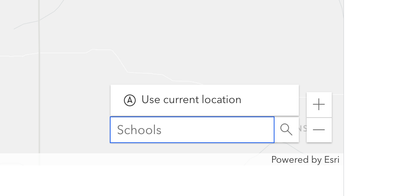

How do I disable this prompt "Use current location" with the JavaScript SDK API for SearchWidget?
I only want to search within the custom source layer. No location needed. I can't find any API for this.

When instantiating the Search widget, set locationEnabled to false:
const searchWidget = new Search({
	locationEnabled: false,
	view: view
