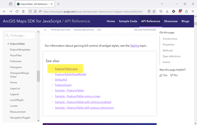

The widget pages should have a link to the css information in the See Also section
You can also right click on the widget and use the Inspect option to get more information about all of its CSS.
