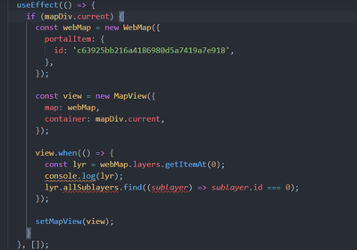

Ok so here is a snippet from the code, I tried to pull out anything that would detract from what I am attempting to accomplish.
The code itself:
const ProjectMap: React.FunctionComponent = () => {
  const mapDiv = useRef<null | HTMLDivElement>(null);
  const [mapView, setMapView] = useState<null | MapView>(null);
    useEffect(() => {
    if (mapDiv.current) {
      const webMap = new WebMap({
        portalItem: {
      const view = new MapView({
        map: webMap,
        container: mapDiv.current,
      view.when(() => {
        const lyr = webMap.layers.getItemAt(0);
        console.log('layer from webmap:');
        console.log(lyr);
        lyr.allSublayers.find((sublayer) => sublayer.id === 0);
      setMapView(view);
  return <div ref={mapDiv} className="mapDiv" />;
export default ProjectMap;

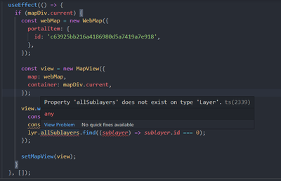

The errors that I am seeing related to the types are:

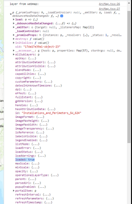

 And the console output of the layer that I initially got from the web map is here (showing the loaded value and type of the item):

The Collection getItemAt method doesn't know you expect to get a MapImageLayer, so you can do this
const lyr = webMap.layers.getItemAt(0) as MapImageLayer;
