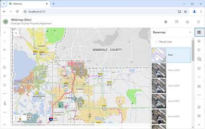

Looks like the basemapGallery needs to be on the map:
In my case, it is on different component (in a calcite-panel):

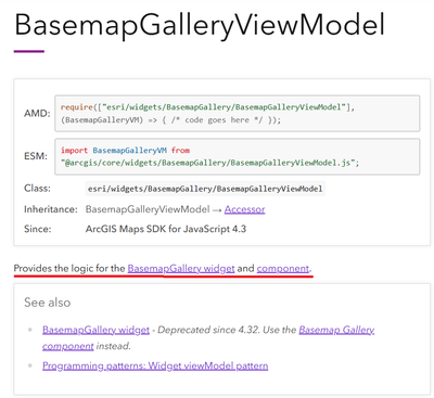

Maybe, I should use BasemapGalleryViewModel? How to use BasemapGalleryViewModel?
BasemapGalleryViewModel provides the logic for the BasemapGallery widget and component. How does it provide?
https://developers.arcgis.com/javascript/latest/api-reference/esri-widgets-BasemapGallery-BasemapGal...?
