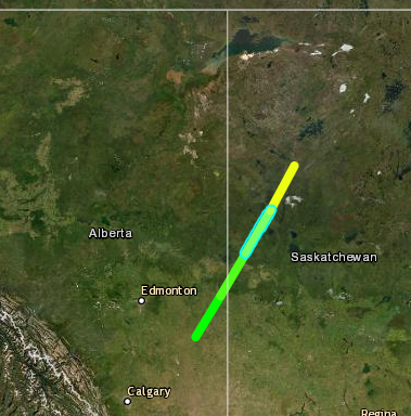

There are some polylines here. I want to click it to highlight it and make it wider. I have found a method to highlight it, but I don't know how to make this polyline wider

 I tried applyEdits.updateFeatures to modify it, but it didn't work
// is ok
map.layers.items[0].source.items[0].geometry = {
type: "polyline",
paths: [
[-111.3, 52.68],
[-120, 49.5]
// width not work
graphic = map.layers.items[0].source.items[0];
graphic.symbol = {
type: "simple-line", // autocasts as SimpleLineSymbol()
width: 40
JeffreyWilkerson

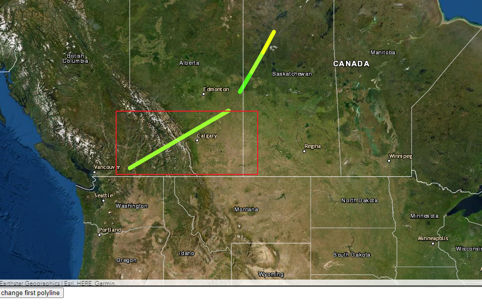

I'm not sure if you can mess with what's already there, but you could add a temporary graphic over the top, and remove it if the click is anywhere else. This works but could use some help in making it the same color scheme:

<button onclick="change()">change first polyline</button>
<script>
  function change() {
    map.layers.items[0].source.items[0].setAttribute("value", 19);
    map.layers.items[0].source.items[0].setAttribute("width", 20);
    map.layers.items[0].source.items[0].setAttribute("active", 1);
    map.layers.items[0].source.items[0].visible = false;
    // is ok

<body>
<div id="viewDiv" style="height: calc(100vh - 100px)"></div>
<script>
  function change() {
    // is ok
      type: "polyline",
      paths: [
        [-111.3, 52.68],
        [-120, 49.5]
    // not work
    graphic.symbol = {
      width: 40
    map.layers.items[0].applyEdits({
      // deleteFeatures: [
      //     objectId: 1
      updateFeatures: map.layers.items[0].source.items
      // updateFeatures: [
      //     objectId: 1,
      //     geometry: {
      //       type: "polyline",
      //       paths: [
      //         [-111.3, 52.68],
      //         [-100, 49.5]
</script>
</body>
</html>
zhedream
      view.on("click", (e) => {
        if (unHighLight) {
          unHighLight();
          unHighLight = null;
        view.hitTest(e).then(function(response) {
          let results = response.results;
          let graphics = results.filter(function(result) {
            // check if the graphic belongs to the layer of interest
            return result.graphic.layer === fLayer;
          if (graphics.length > 0) {
            let graphic = graphics[0].graphic;
            highlightGraphic = new Graphic({
              geometry: graphic.geometry,
              symbol: polylineHighlightSymbol
            view.graphics.add(highlightGraphic);
            view.whenLayerView(graphic.layer).then(function(viewLayer) {
              // let highLight = viewLayer.highlight(graphic);
              unHighLight = () => {
                // highLight.remove();
                if (highlightGraphic) {
                  view.graphics.remove(highlightGraphic);
                  highlightGraphic = null;
          } else {}
This is a very good idea. It can basically achieve the effect I want - to overwrite the original figure with a new figure
There's a little problem. I don't know how to highlight the new graphics. It would be perfect if I could
