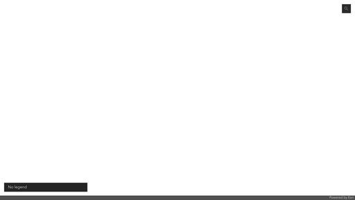

ReneRubalcava
Esri Frequent Contributor
See https://community.esri.com/t5/arcgis-javascript-maps-sdk-questions/how-to-combine-the-new-component-...
<arcgis-map item-id="d5dda743788a4b0688fe48f43ae7beb9">
	<arcgis-expand position="top-right">
		<arcgis-search></arcgis-search>
	</arcgis-expand>
	<arcgis-legend position="bottom-left"></arcgis-legend>
</arcgis-map>
<script type="module">
	const esriId = await $arcgis.import("@arcgis/core/identity/IdentityManager.js");
	const OAuthInfo = await $arcgis.import("@arcgis/core/identity/OAuthInfo.js");
	console.log(!!customElements.get("arcgis-map"));
	esriId.registerToken({
		server: 'https://www.arcgis.com/sharing/rest',
		token: "YOUR_TOKEN_HERE"
	esriId.getCredential("https://www.arcgis.com/sharing");
	esriId.checkSignInStatus('https://www.arcgis.com/sharing').then(async (responseSignInStatus) => {
		await import("https://js.arcgis.com/map-components/4.32/arcgis-map-components.esm.js");
	}).catch(function (error) {
		alert("Register error message: ", error);
</script>

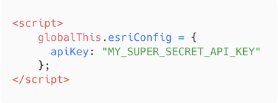

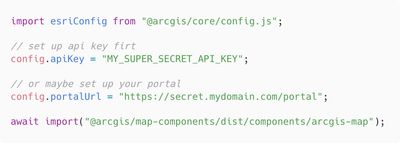

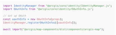

When using the NPM package to build your apps, you can set up your authentication or api keys before importing the components. Sorry for images, but I have these on hand from presentations.
If using the CDN, you can do a couple of things. For API keys, use the global esriConfig before the script tags for core js and components.
Or similar to how you would do it in NPM, do your work first and then import the components.
